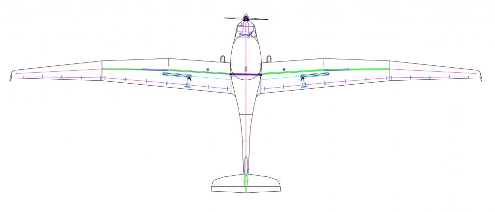

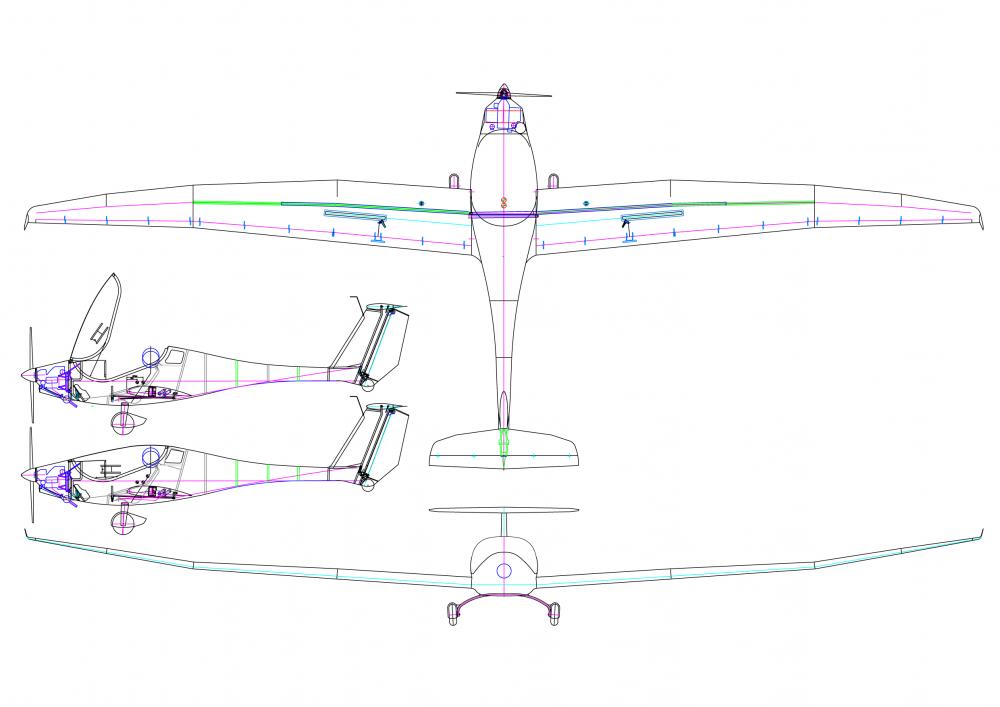

Martin Stepanek Posted February 4, 2016 Author Report Share Posted February 4, 2016 One of ideas to improve existing Phoenix airplanes (yes, I mean all already produced Phoenix airplanes) is based on the results of wing strenth testing. Theoretically we can increase wing span to 16 or 17 meters. Of course would be necessary to make Vne limitation. For example (not calculated yet): short winglets Vne = 120 kts 15 meters wing ext. Vne = 120 kts 16 meters wing ext. Vne = 100 kts 17 meters wing ext. Vne 90 kts Just an example.... to show you that decission is - or to make 16 meters wing ext. with small limitation, or to make a 17 meters wing ext. with bigger limitation. System of connection would stay the same. And second question (now more about design).... Would you prefere to have extension leading edge straight (version 15.17) or with one more bending (vesrion 15.16)? Suggestions and coments are welcome :-) Best regards! Martin Quote Link to comment Share on other sites More sharing options...
edwalker Posted February 5, 2016 Report Share Posted February 5, 2016 Hello, Martin - Welcome to the forum. We're delighted that you have time to participate. Many of the owners post here, and you can get a good idea of how things have developed over the years. I have U15/05, and it is doing quite well. It is a wonderful work of engineering, and it has been the most enjoyable aircraft I have ever owned. I'm sure the owners will be passing along a good bit of feedback and ideas in the coming months. Regarding your question about longer wingtips, I think there might be some interest if there were a large enough improvement in performance to justify the cost and Vne penalty. My advice would to create the greatest possible improvement in L/D rather than just a small, incremental change. That way you would have a choice between using the 15m tips for more casual local soaring and the 17m for more ambitious trips where you are pushing your skills. I rarely need to go above 90kts anyway, so that doesn't seem to be a problem. By the way, make sure you turn on the email notification function of this message board so you be made aware of new postings as they occur. I hope you come and post frequently to let us know what you are thinking and how we can help. Ed Quote Link to comment Share on other sites More sharing options...
Martin Stepanek Posted February 7, 2016 Author Report Share Posted February 7, 2016 Thank you Ed, I have the same feeling - to improve L/D even if some speed limitation will be necessary. They are two areas on the Phoenix we are actually looking to. Already mentionned idea of longer wing extensions and some design modification on engine cowling :-) My friend - Mr. Potmesil from HPH (http://www.hph.cz/index.php?lang=en) offered me help in case we will need CNC to make prototype moulds - that could really help. Best regards! Martin . 1 Quote Link to comment Share on other sites More sharing options...

Jefferson Posted February 21, 2016 Report Share Posted February 21, 2016 Hello Martin! Welcome! I would love to have 17m extensions, and 90kts Vne is fine in that case. Bent or straight is okay. I'm sure you will maintain the good looks. My ship 15/23 is doing fine. A wonderful ship. I agree that we need many more in the USA. There seems to be a great demand. 1 Quote Link to comment Share on other sites More sharing options...
Gfeldman Posted March 3, 2016 Report Share Posted March 3, 2016 Hi martin I have just purchased my Phoenix and I too would really like to see extensions that would bring the span to 17meters developed. 90 kt cruising speed is fine with me. george feldman n33gf Quote Link to comment Share on other sites More sharing options...

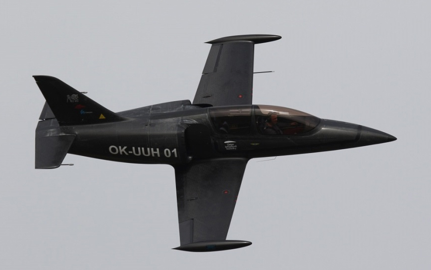

Martin Stepanek Posted April 5, 2016 Author Report Share Posted April 5, 2016 Hello dear friends! This time is my information not about TMG, but I am very glad that work of my friends from Czech Aeronautical University has been finally succesful :-) Project name is UL-39 Albi. More photos here... https://www.zonerama.com/JaFR1/Album/1293931 Some videos here... http://www.gonzoaviation.com/clanok/uhlikovy-albik Best regards! Martin Quote Link to comment Share on other sites More sharing options...
Registered Eric Greenwell Posted April 13, 2016 Registered Report Share Posted April 13, 2016 Hello Martin! I am pleased to see you posting here. After all, the designer is the most likely person to have good ideas for improving his designs! 1) I would prefer 17m tips, even with only a 90 knot Vne. A smaller change in performance would not be worth the expense, and my hangar width means even the 15 meter tips must be removed. I would still use the 15m tips for traveling in "airplane mode", for safety reasons as several pilots have stated, for casual soaring the trip. 2) Would the current 15 meter wing benefit from zig-zag turbulator strips on the bottom of the wing? Zig-zag tape is cheap, and easy to install, but you must know where to put it. 3) The lower cowling looks like it produces quite a bit of drag, compared to a "smoother" design that closed the cooling intake with a streamlined cover. Also, a fairing for the exhaust pipe seems worthwhile. I'm sure you have thought about these changes and worried about the cost and complexity. Perhaps a more streamlined lower cowling could be offered as a an option for new gliders, and as a retrofit for already delivered gliders. 4) Another place I can see for improvement is the junction of the fuselage and landing gear legs. I don't know if that area has significant drag, but with the gap just above the gear leg at the fuselage, and no fillet to fair the gear leg to the body, it looks like it might be worth improving the airflow in that area. 5) Air comes into the cockpit from the spoiler and flap slots, and also from the seat belt holes in the seats. I think this air leaks in from the wing. Perhaps the sealing of the control surfaces or the wing root should be improved? This might be easy for the owner to add, if he knew where the sealing would be the most effective. Quote Link to comment Share on other sites More sharing options...
Martin Stepanek Posted April 14, 2016 Author Report Share Posted April 14, 2016 Thank you - good ideas dear friend! From calculations seems that 17 meters wing ext. modification will improve 3 points on L/D = I am very interested to produce them :-) I will try to find out if zig-zag would improve characteristics and optimal position. I fully agree that lower covling need some modifications. Jim asked me for one spare cowling to improve it, but I understand he had no time to work on it. At least would be good to make air intake more streamlined when is closed... Junction between fuselage and landing gear... well that is a challenge. Landing gear is flexible so would be necessary to use something "soft". Pls. have you on your mind some solution? (drawing, photo from other airplane...). Seal the control lines? Well... maybe, but definitelly will be a challenge to do it without to add "resistence" in control lines forces... I would like to start with zig-zag tape, second goal is cowling re-design and paralelly 17 meters wing ext :-) Than you for your comments! Best regards! Martin Quote Link to comment Share on other sites More sharing options...
